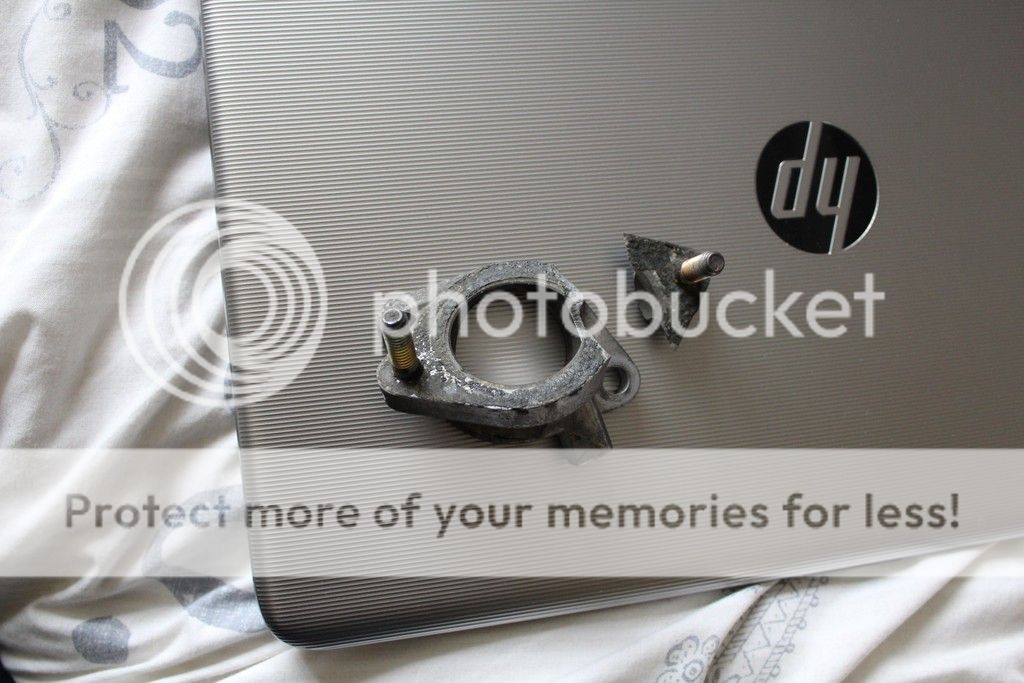

Just become the owner of an R33 GTR recently.
I'm working my way through it's many problems.
Today it's boost leaks, fixed one of the main intercooler hoses which was badly fitted.
Found another leak but this time it's worse as something is broken, but I don't know what to call the part and need one urgently.
It attaches under the baffle pipe to the top of the front turbo.
[IMG][/IMG]

Is it this part labelled as 'air outlet tube' on page 184 of the R33 engine manual? Attached screen grab.

It sure is mate!
Had a look and can't seem to see a part number anywhere for it.

14460-05U01 TUBE ASSEMBLEY, INLET

Legend brilliant mate.
Just need to find someone who has a new one in stock for quick delivery, not sure if a used one beng 20 years old will be much use.
Cheers again!

If you cant get a used one call in to your local nissan garage
