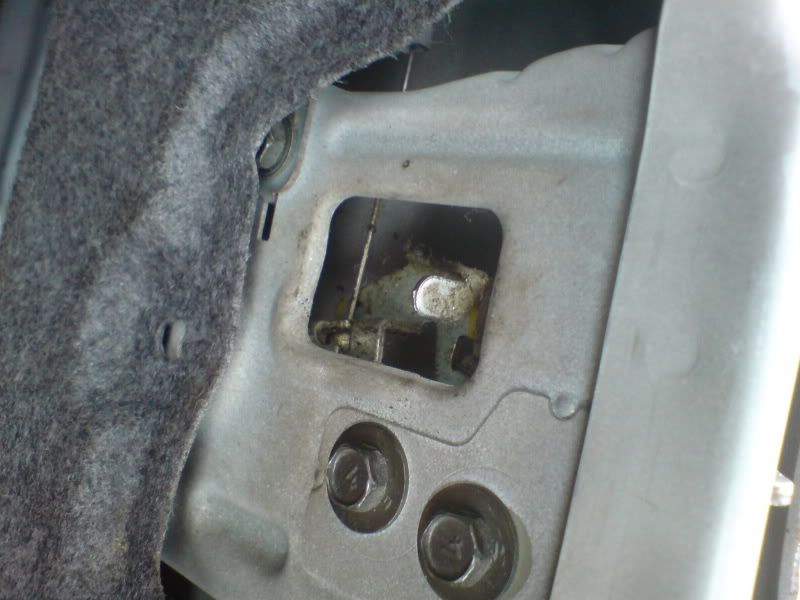

hi all changed the battery in my boot yesterday went to open it today & wont open with the key or pulling the handle grrrr
any ideas on how i can open :crazy:

turn your key in it and grab the very bottom of the lid and lift as hard as ya can,
tried but the key wont turn at all & was fine before that
Rear seat back out,undo a panel to access the boot,use a long stick type thing to reach the lock and flick the bottom of the catch up,it will then open with the handle.:)
When you get it open, look at the lock mechanism on the car, not the boot lid. There's a small lever there that restricts the access to the boot. Either push it or pull it (opposite of whatever it is now) to stop the problem happening again.
see mine works fine using the lever but key just wont turn, it has always been fine then one day the key just wouldnt turn in the lock
