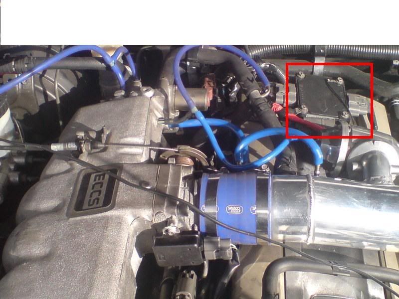

Right my R32 Rb20det coil packs died, so i replaced them with spec 1 r33 coils which have also now died, tested with fat blokes split fires and the worked fine. Now i have a set of r33 spec 2 coils they look identical but the lugs for the leads to clip onto are about 1mm different, so the lead wont clip on.
The spec 2 dosnt make use of a ignition amplifier, so my question is if i just filed the lugs off would the spec 2 coils work with my engine which uses the ignition amplifier (below)
Autobahn Burner
1,223 Posts
NO DON'T DO IT!!!!!!!!!!!!
you will ruin the set of coils as spec 2 coils have the amplifier built in, might even fry your chip!
