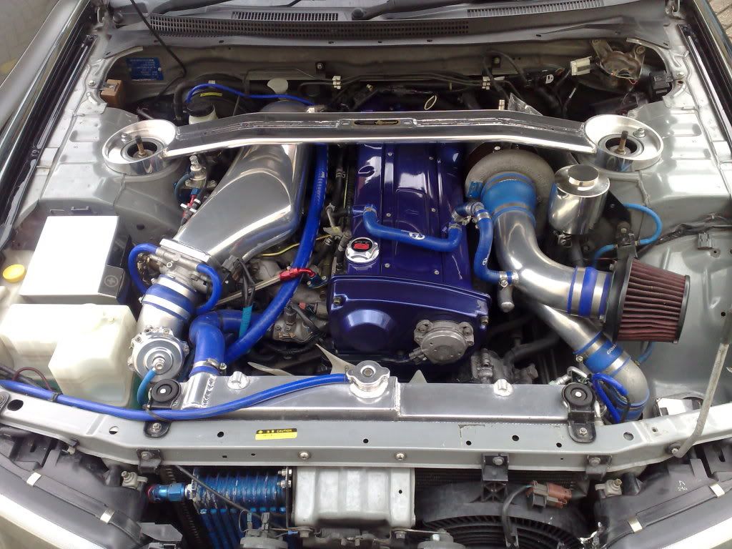

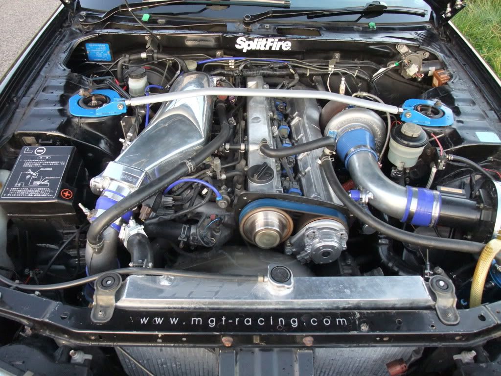

Making an Elbow/downpipe should be easy for anyone with the right tools to make. I wouldn't wory about that. Depending on what manifold you go for and where the turbo ends up sitting you'll probably get away with just having to make an elbow
Here's mine....
Plasmaman Plenums look the biz.... :drool:
