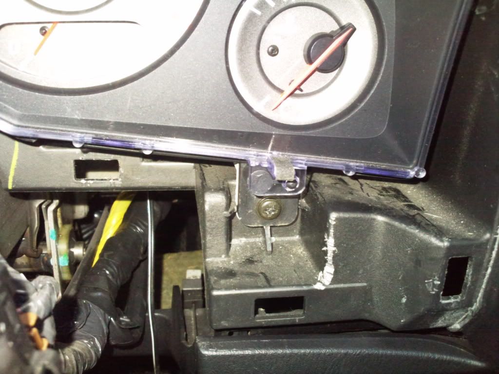

Next we have to tackle the steering wheel surround/speedo cluster.

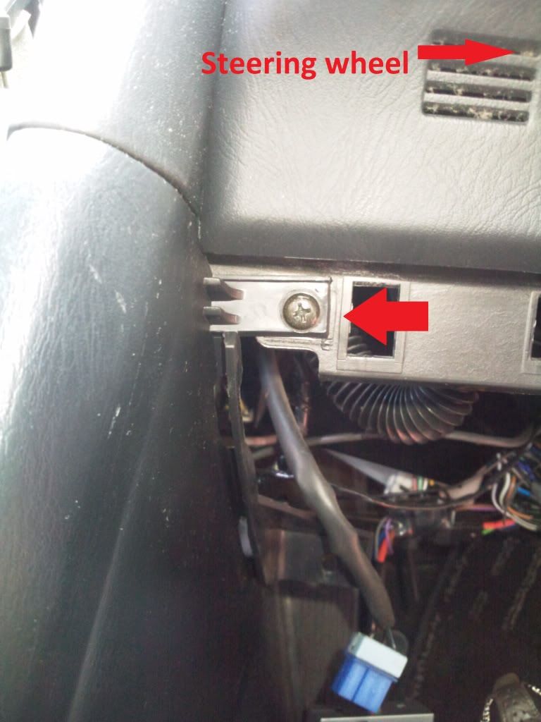

Look up under the steering wheel and remove these screws
Now take of the surround as per here:

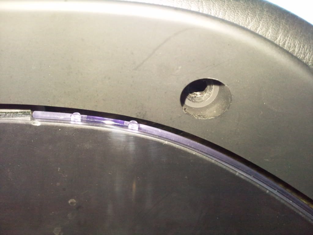

There are some screws on the top of this arch, remove and pull out the surround
Don't forget to undo pipe and connector on the left

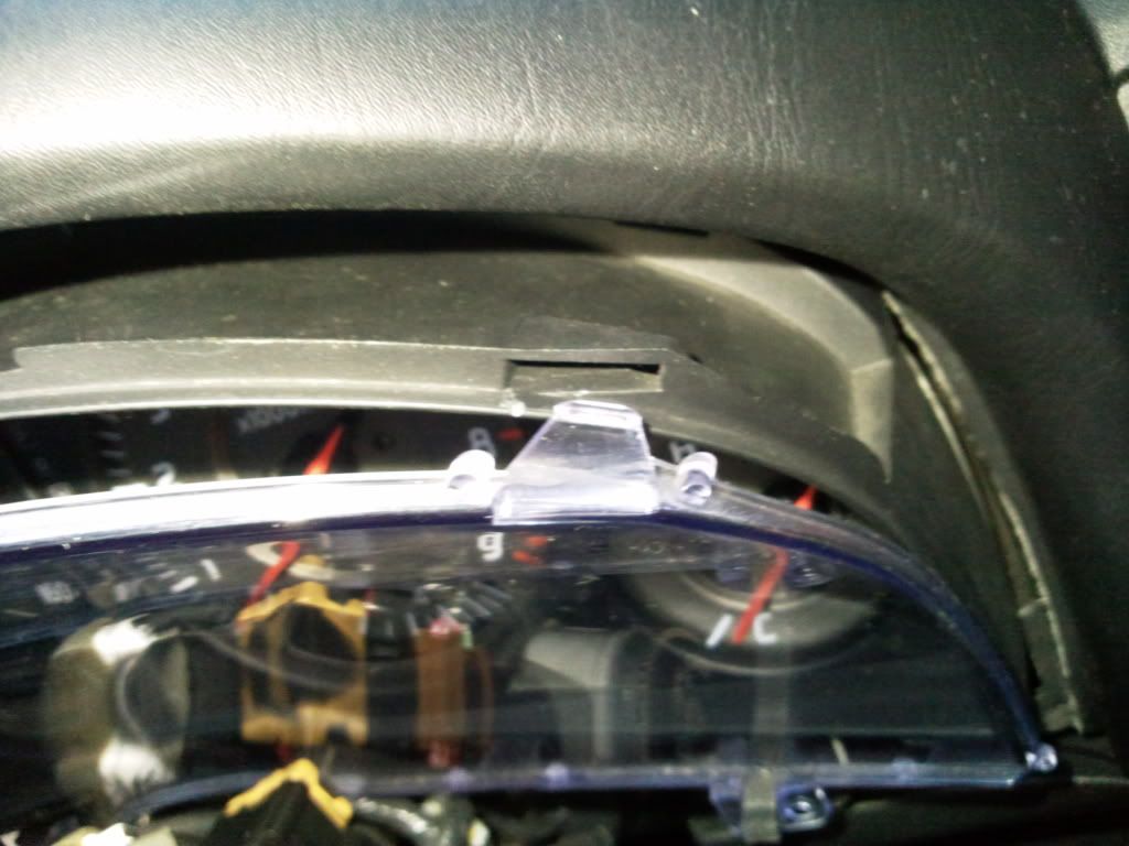

Undo the screws above and below the perspex screen
Unpop perspex screen, be very careful, do not scratch the screen
Depending on how thin you arms are, you can leave the cluster intact, I found it easier stripping.

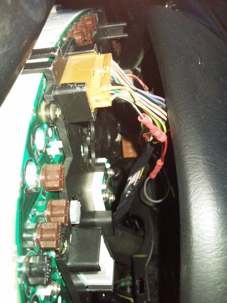

Remove the black tags seperating the black from the white parts

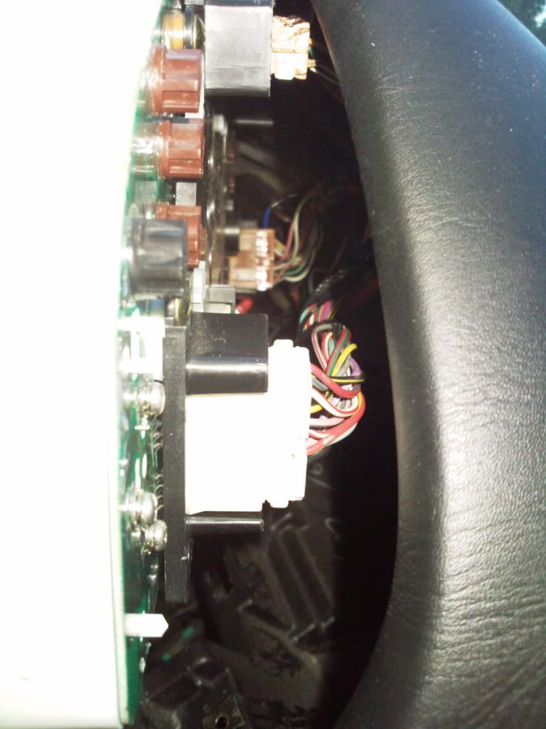

Very awkard to get to, but undo these connectors
and
Now remove the cluster, disconnect any wiring and point to note, behing the cluster a few wires are cable tied to the dash interior, undo these.

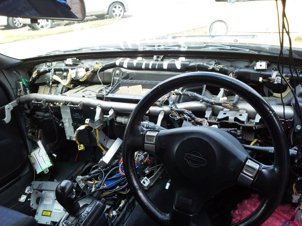

Bobs your uncle and fannies your aunt, it should now come out, warning heavy and might be best getting someone to lend you a hand.
