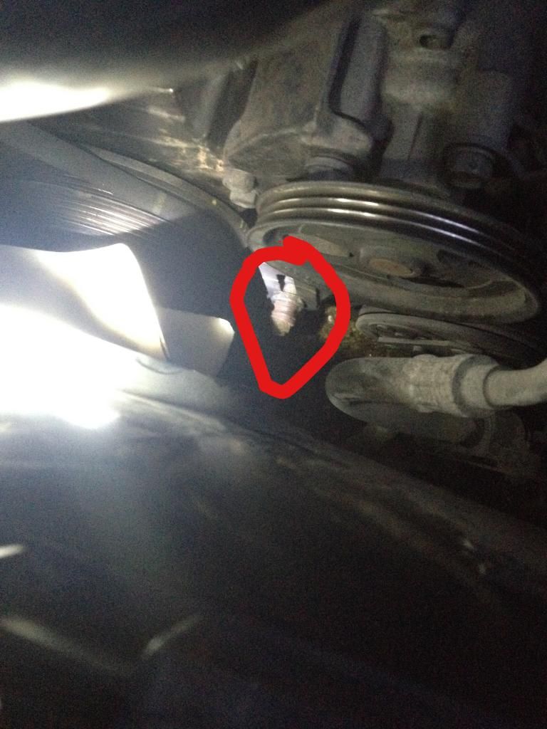

So, one of my belts snapped recently and threw another belt off (AC/PS) and looking at throwing new ones on tomorrow, but just want to make sure I'm not overlooking anything....
is it as simple as unwinding the tensioners, slipping the belts on and tension back up? or is there more too it, any help/images on what bolts i need to be looking at would be great!
also what's this thing in the photos? (circled) It looks like it should be a pulley on it...., fallen off perhaps?
this is for an R33 RB25DET 1995

Chris not sure if it's any use buddy but I have just removed my complete air on system and have that pulley here if you want it?
I'm literally just going to bin it tbh so if your happy to just cover the postage then you can have it buddy. May still even have a belt somewhere although tbh, for the sake of 6 pounds you can buy new
Pm me if it can be of any use mate
As for belt change, very simple. Undo tensioner and the main bolt pivoting the pump, replace belt tighten with tensioner bolt and nip up pivot bolt
Good luck mate

Ok guys, jsut about to tackle this.. have I got this right...
Loosen bolt [1] (tension screw)
loosen bolt [4] (pivot bolt)
or do I need to remove the bracket bolts [2]/[3] too?
