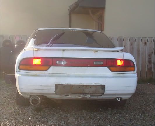

Recession Drift update
After our introduction to our Recession Drift project last mouth, Its time for a proper update on its progression. First on the agenda was to push our beat up 200sx into the garage to undergo an extensive examination to see what needs to be done to the car before we start adding bits to it. The first to come were the bumpers and the bonnet and next the wings mainly because the passenger side wing had definitely kissed a few walls and hedges in its day and it seems the previous owner thought he would fix it with a sledge hammer and a load of filler. Lucky for us a very good friend of mine that drifts a 180sx just so happened to have two spare front wings just laying about after changing his in favour of a of 6" wider set and he was kind enough to just hand them over. This being a "recession" drift car this was a great find in keeping the cost down to a minimum so fingers crossed that happens a lot. With the car striped down to what I can only call a shell and the interior striped out we did notice some rust spots that needed some attention but other than that everything seemed ok so "bring it on" time to start looking for more parts.
With most of my car history in the showcar scene I'm big into how a car looks as well as how it performs, so straight on the Internet i go to get some influences on how i want the car to look. In my opinion GT wings set off most drift s13's so when I found a carbon look gt wing on ebay for under 50 bucks delivered i had to have it, another big saving for us in the long run, Also after a lot of forum searching i managed to pick up an exedy clutch that hadn't seen a lot of miles for free from a guy that replaced his for a paddle clutch so happydays. I'm not going to give to much away but for next month I may have something special lined up in the styling department so check back and find out.
There will be more pics posted later camera died :(
Also we found a cheap as chips engine??????? :drivin:
