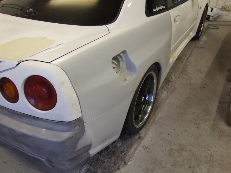

Hi Guys ..been working on our latest wide project over the last 4 weeks namely the GTT to GTR 34 conversion ..
We have the east Bear rear quarters which are 2" wider than the GTR 34
These are bonded on and we use brackets to keep the arches out from the body work so that the GTR side skirts and rear bumper flows with the body line ..think this is a most attractive part of the car too..
We dont use GTR rear liths but reform the GTT ones so they follow the lines of the rear quarters ..and along with that we have the petrol flap too but here we are poss going to use this set up ..
we have the GTR34 front wings which work well with the sideskirts in GRP
Very good fitment as you can see We can vent these to if any one is interested in their own personal design..
