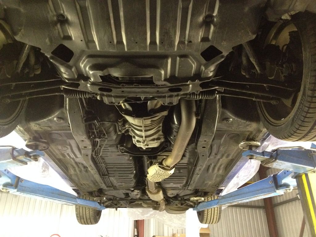

Then I got her up on the ramp to have a proper look underneath and start making some plans for mods since I didn't plan to put her on the road until march time for summer.

Looks immaculate, get it undersealed to keep the rust away,but looks like you have yourself a fantastic example!
