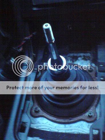

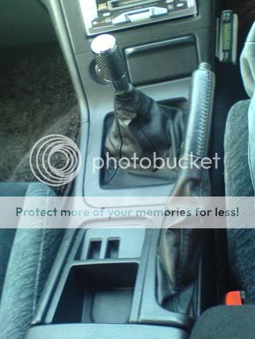

New gators \ short shifter (40% reduction) \ NISMO carbon gear knob [ Sept 2008 ]

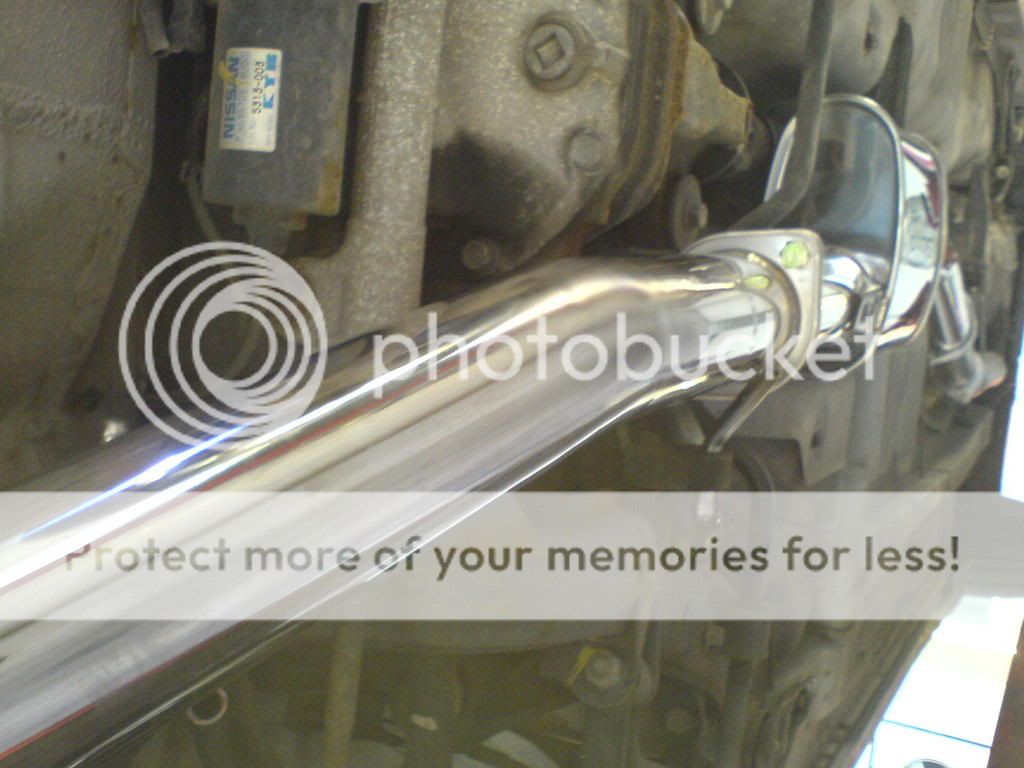

Full Trust exhaust and Trust downpipe [ 17 Oct 2008 ]
