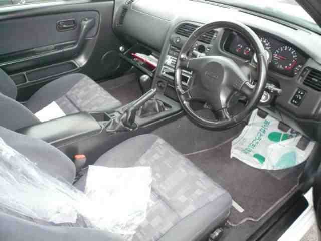

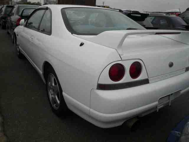

After a quite a bit of trawling through the auctions i decided to get a bid placed on a white 1996 r33 gtst. Soon after i was informed that the car came up well under my budget :D
Next was the waiting game, for what seemed like a eternity for the car to arrive :40oz: but this is what i had invested in;
Pretty much bog standard gtst apart from an hks air filter and hks exhaust, perfect base to start working from :D

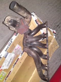

First disaster struck soon after however :(:( when out setting up the boost controller for 0.85bar it momentarily spiked to around 0.99/1bar and i heard quite a loud "Pop" hmmmmmm, intercooler pipe blew off i though, so drove back home roughly 1 mile away just to find that all ic hoses were fine hmmmmm what was the pop??? as the car was idling i started to hear a faint ticking noise.... wtf is that noise..... ticking got louder and louder at which point i phoned the local nissan doctor who immediately diagnosed the ticking as a death rattle, looks like my bottom end has had it. Bugger
So trailered the car up to him and he started about seeing what the problem was , turns out the bloody turbo had blew the wheels clean off itself, and on hearing the pop i let off the accelerator which seems to have pulled all the **** into the engine and spun my bottom end :(
At this point i went with a conceptua tuning 375bhp turbo and new bearings for the bottom end with a 1.2mm cometic headgasket, got off quite lightly everything considered.

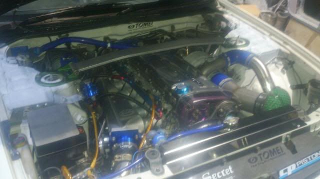

Greddy top mount manifold, hks 50mm wastegate, 1.2mm cometic mls headgasket, bltiz 550cc sidefeed injectors, and a gt3076 turbo.

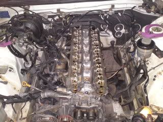

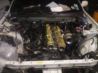

Schweet :D so time to get that all fitted up to see what it was going to look like, que engine stripping number 2 lol;

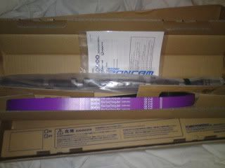

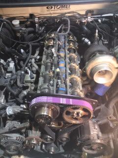

at this stage i fitted a set of tomer poncams aswell, 256 duration 8.5mm lift, nice plug and play cams, and an hks timing belt;

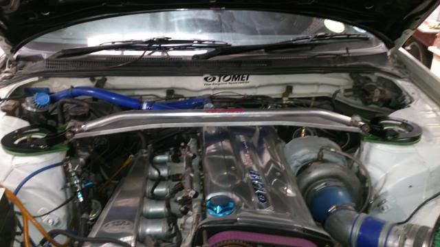

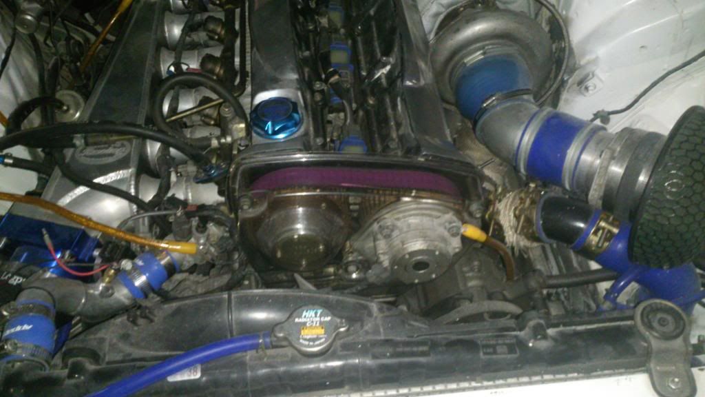

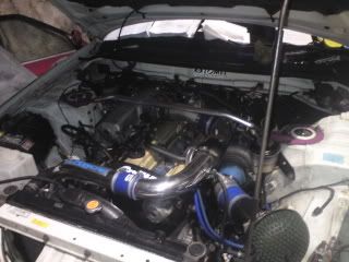

painted the cam covers gold and got the manifold fitted up
all finished ready to sort out what engine management im going to be running :D

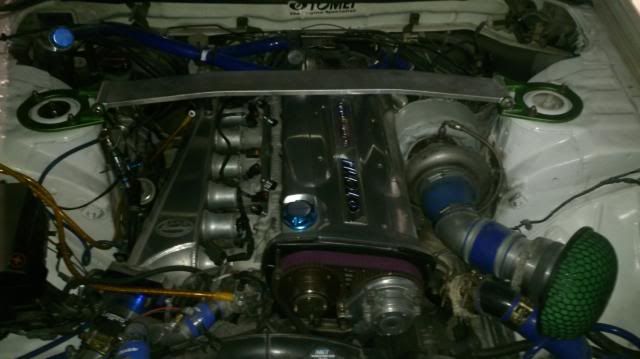

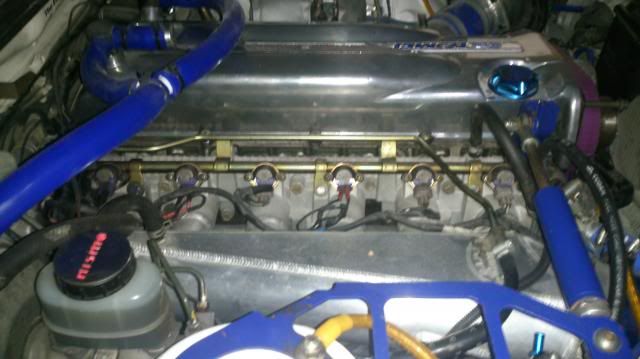

but of course that doesnt last long......... i always fancied a side inlet plenum....... so i went ahead and ordered myself a Rips intake plenum :D and to go with it decided a set of rb26 cam covers would look good too so set about getting everything fitted up. (only a few pics of this stage as i got a bit carried away fitting parts :( )

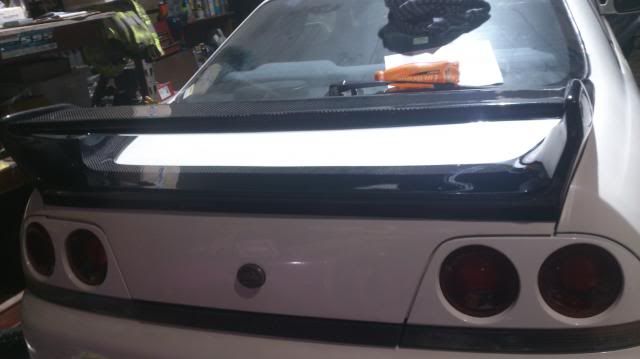

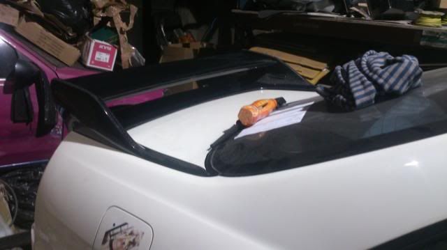

in amongst the excitement of engine work, i got myself a full carbon r33 gtr style spoiler to replace the spec 2 spoiler, looks much better i think :)
so engine ready to go for its next stage of setting up;

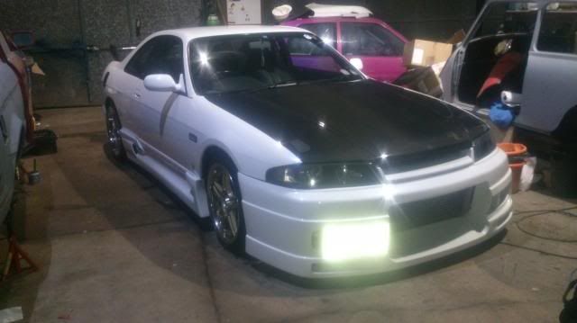

and a couple of pics of how the car was looking at that stage;

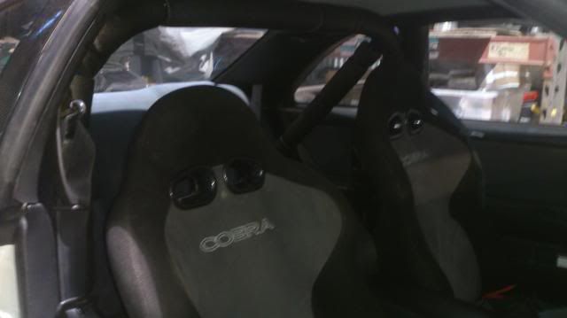

I had started to do a bit of interior work at this stage, new seats, gauges, rollcage etc;

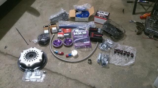

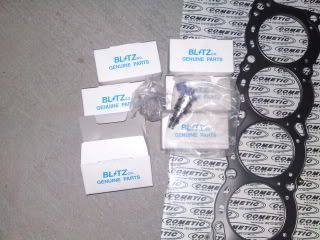

Hks gd pro triple plate clutch, head drain kit, piper valve springs, hks cam gears, RC 1200CC top feed injectors, hks ssqv 4, 2nd walbro fuel pump, new water pump, extended crank collar.
hmmmm ill need a few other bits and pieces to get the best from the above package, sooooooo, this happened;

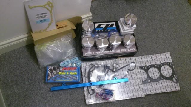

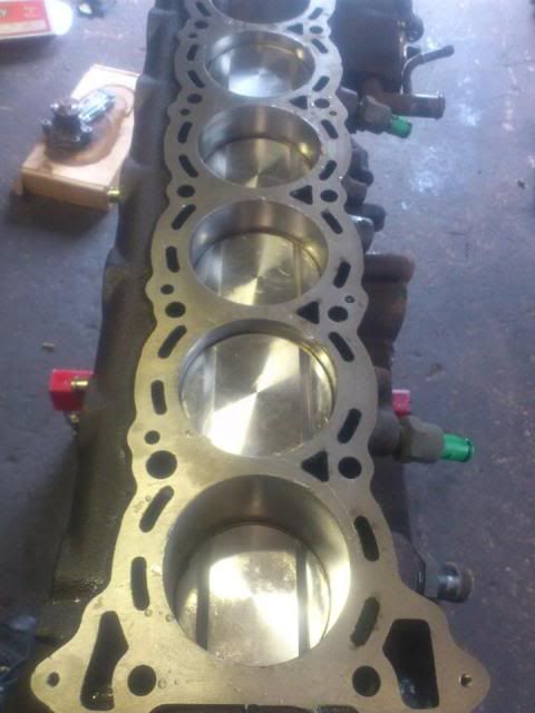

86.5mm cp pistons, 11.0mm greddy fuel rail, nissan n1 oil pump and oil pump gasket, arp head studs, cometic bottom end and head gasket kit, nissan core plugs.
Looking good but the rods were missing from the order, shortly afterwards my Manley conrods arrived :D no pics unfortunately of them.
Next mission was to get the car up to my mechanic to get the above bits and pieces fitted and the link g4 mapped for the 1200cc injectors so i can start the run in miles :D

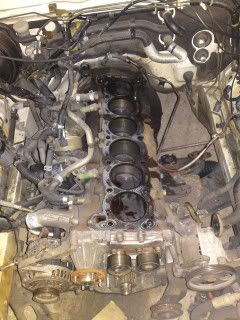

Few pics of the engine being built;

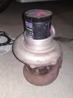

Just before i left the car up for the final map, i made a bit of an impulse buy.....
Precision 6262 :D :D :D
this will be fun when i get her back again.

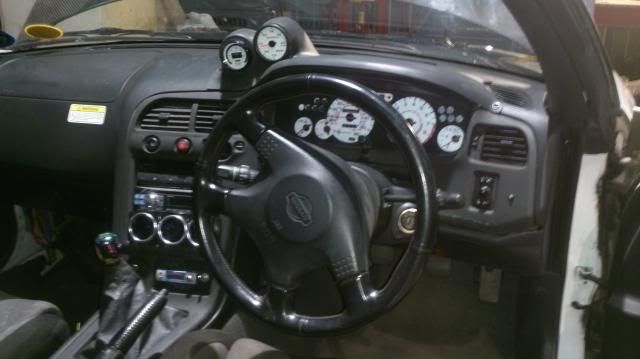

and a quick pic of my new gauge set up, replaced the steel gauge holder with a bit of carbon to hold the defis in (excuse the non reading oil temp gauge, i hadnt plugged it into the sensor :doh: )
thats all for now folks, hopefully have a few more updates soon :)
