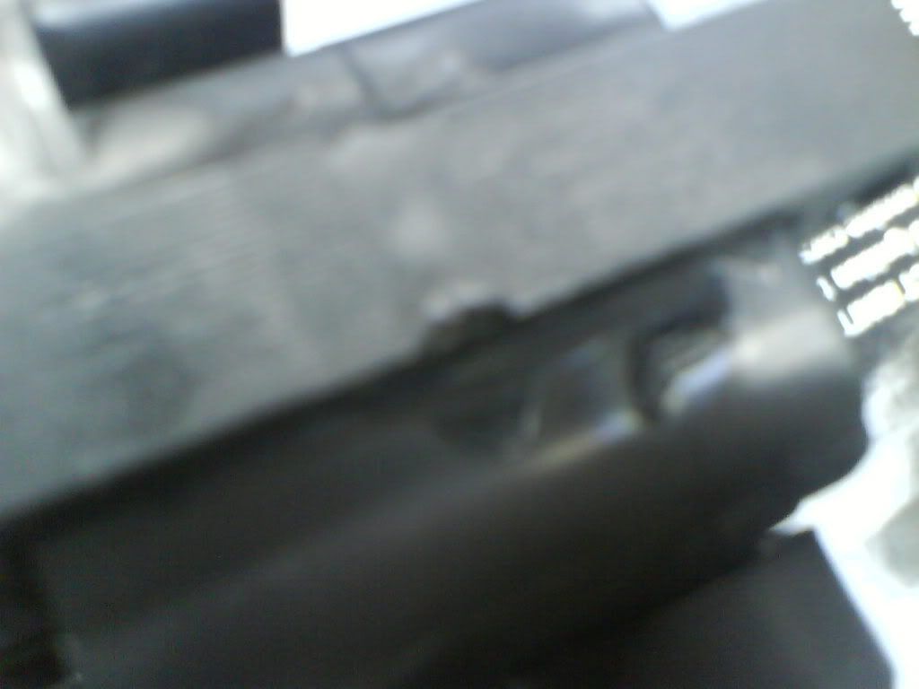

Here was my problem
no wonder the car was spitting all the time.

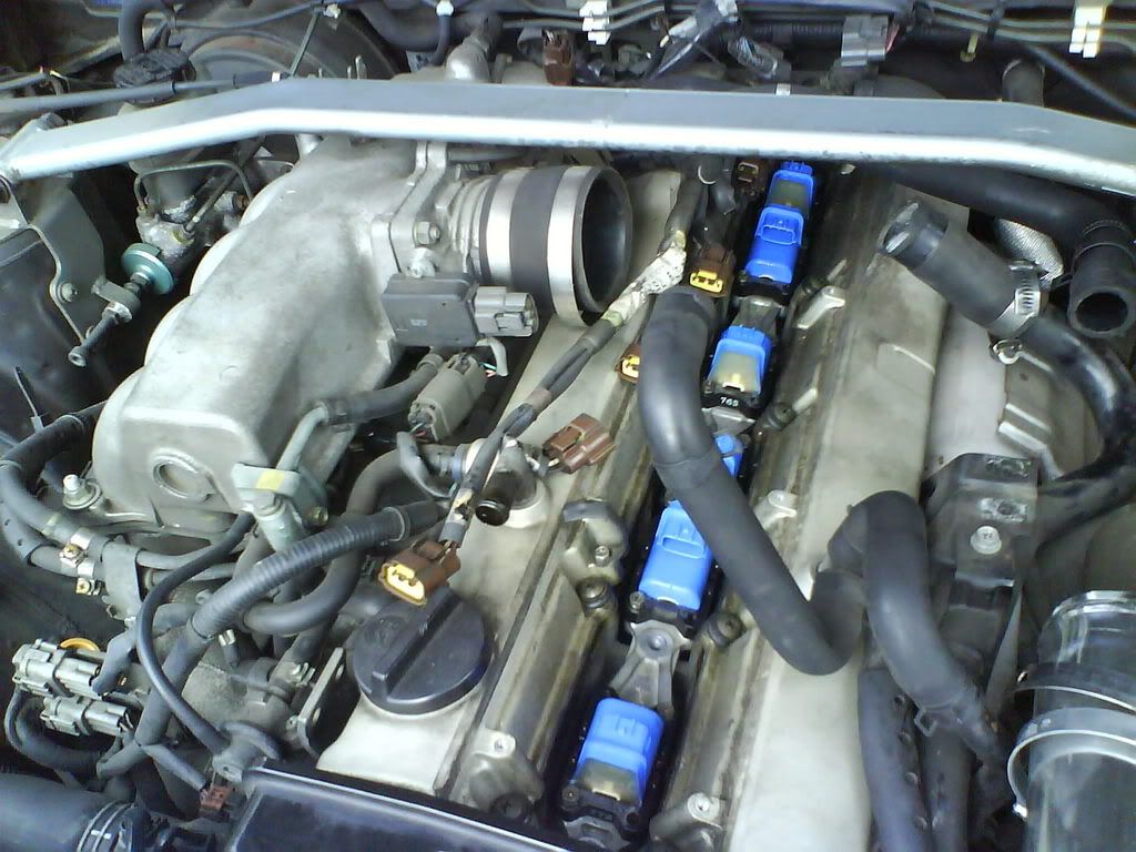

Well now the splitfires are nestled in and the car drives like a dream, and ive been able to wind the boost back up to 0.8 bar :D

I took My plugs and changed them back due to having a misfire until the car was at full working temp. When I took the coil packs out every single one had Insulation tape wrapped around it ????
SO I think I will also be investing in a set of those Fella :D

well worth it, the car is even smooth on the low rpms :)
Best £300 ive ever spent

I had a horrible miss fire, the car wouldn't run smooth at all. Ordered a set of Spitfire coil packs from nengun.com and it solved the problem straight away, I've got beautiful smooth power again :D
Only cost me about 320euro shipped to Ireland too so seem to have got a good deal.
The insulation tape around them is supposed to be a cheap fix or something like that :uhoh:
