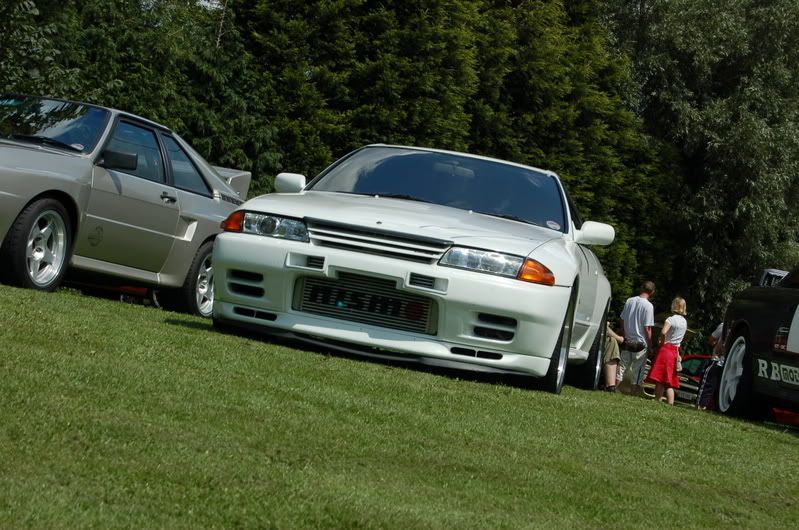

Possibly not to everyone's taste but its a great way of closing that gap between the bumper and the floor for both appearance and to stop that air from getting under. Its subtle, but just finishes the front end off nicely.
The front splitter is OE as fitted to Seat Leon Cupra R's and is easily applied using self tapping screws, or bonded for a stronger fix. Mine is just screwed on, but its hellishly secure, its bottomed out a couple of times but its held on as though it was fitted at the factory. It fits perfectly with the contours of the original GTR front bumper, but I should imagine it would fit other models too.
If you are interested then speak to your local Seat dealer, and quote part # 1ML805903 - I'm in the motor trade so I got a little bit of discount but it ended up costing me £19.37 inc vat :smoker:
as it comes:
fitted to an R32:
sits nice and low on grass:
Hope this is of help to some peeps looking for a 'cheap fix' :smoker:
