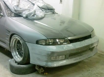

Last winter i buyed this old nissan and made some body mods. I started the project by aquiring Kerscher 9,5"/10,5"x18" ( ET-5 / +5 ) rims straight from the factory. Then i started to modifiy the body around them. I widened the body by welding wider arches (+5cm each side)
Welded wider arches (+5cm each side)
Wheels are Kerscher 9,5"/10,5"x18" ( ET-5 / +5 )
Now its winter again and car is in the garage and waiting for a new paintwork, rear spacers with longer studs, front lights, turbo update...

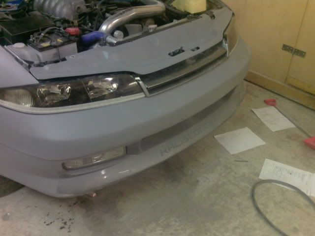

Thanks for comments :) New used black head lights are here:
Maybe carbon front grill works with those? I have planned that new colour would be darker silver, any ideas ?

Started to work glass Fiber Cooling Plate... In this month I must decide new colour, damn it's difficult :bs2:
