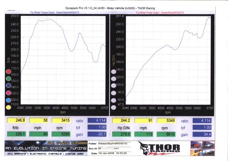

can someone with a SACF2 please post their map up (NE points values) so i can compare with mine (and what mods you have also please). (i realise the NE points will be set at different intervals but i can get an idea, mine adds fuel EVERYWHERE basically, as you can see in the dyno graph the AFR and power curves are not good)
Im not going to make any alterations myself, but id like to know if im adding fuel where others are removing it.

plotting those values on my dyno result suggests (to me who knows nothing about mapping) my loss of power coincides with throwing 12% extra fuel at 4200rpm!

thanks. yeh im not going to change it myself, not worth the risk without knowing the AFR in realtime.. Ill get it on a dyno and have it remapped.
Just interested to determine how 'good' this map im using is as it doesnt seem ideal to me (but i know nothing about maps i admit!)
Ive been plagued with 4000+ rpm lack of power for ages (hence the new spltfires coils and plugs just put it) but now ive seen the fueling im thinking that may be the problem)

yes, i know overfuelling is to protect against knock, but this seems way too much. It looks to me like its just wasting fuel and reducing power.
