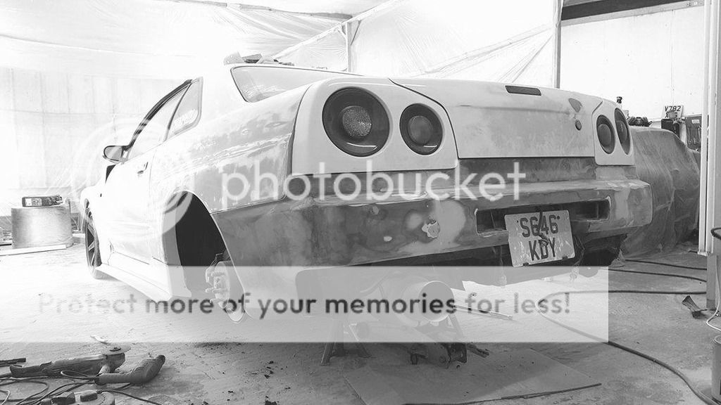

So previously i sold my S15 to try and get out of drifting and bought a R34 GTR instead, Spent abit money on that to make it how i wanted but it turns out they really arnt that fun to drive.... which was a massive disappointment for me!
So, i decided to bin off the GTR make some money along the way and build a Ztune rep drift car with more a punch.
Here was my GTR
Luckily the guy who bought my GTR had a Tommy Kaira R34 which was super clean, low milleage and he had owned it for years so i know it was looked after. A few people moaned because we ripped a Tommy kaira apart but it was a looked after car so didnt want to buy a shed :)
Here is the car:-
literally did 100 miles in the car and i took it straight to desire motor factory to have all the bodywork fitted, custom skirts made, tubbed rear arches and a full colour change including engine bay.
Current Spec:-

4 weeks later i picked up my car and over the moon!
Since collecting i have flatted everything down, machine polished it, fiddled with the suspension set up, changed the wheels and fitted some buckets.
Getting there now!
