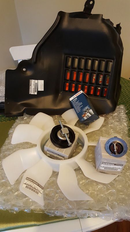

On closer inspection, it appears the washer on the crank bolt had collapsed and the pulley was having a wobble! Crank bolt was tight so no issue with it coming off.
Ordered some new parts from rhdjapan and kudosmotorsport to keep it running sweet. I noticed that the viscous fan had hairline cracks all over it so picked up a new one. Along with a new passo arch liner, new stock thermostat, AC pulley & bosch fuel filter.
Once it had all arrived, off down to TDP where they sorted out the crank pulley bolt/washer, fitted the new oem thermostat, new fan and AC pulley. When i went down to collect it, we went out and fine tuned the Link ecu. The engine was running much hotter now and the Link ecu was alot happier. Some extra fuel added in down low the lumpy idle has almost gone and boost tables tweaked she is pulling like a train now. much nicer to drive.
I guess the nismo low temp thermostat was making it run too cold for the Link ECU. Either way, it is alot better now!
