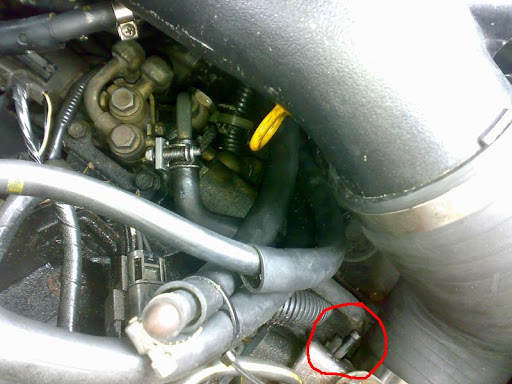

You may have seen my other thread on my lumpy / high idle, well I took the whole lot apart again and added some loctite copper gasket to every surface and my lumpy idle has gone :) still high idle though but no where near as high, it was 1900 now is it 13-1400.
I have taken some pictures of the way the FMIC is plumbed in, could this be a factor in my high idle problems? Can any one explain why that pipe is open and the other smaller one is the engine bay blocked off? I have reattached the small pipe to the correct nipple circled with no change in idle, but when connected the bov makes a ticking noise when revved not sure if this is normal or not? Please some one explain :) I feel like I am almost there, just need a little help :)

Update.
I am missing the recirculation tube circled red.
The part with the green arrow is open and can be see in the pic which is taken from the front of the car.
The part with the blue arrow is blocked.
Is this causing the high idle, what else could it be causing, why has it been done? Will be taking the BOV's off tomorrow to check for problems, the main question is, is it causing the high idle :) Sorry, lots of questions I know
