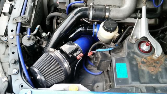

Up on further investigation I discovered my air filter had fallen apart, the silver bullet shaped thing on the end has gone and my filter is now in 3 parts so I'm wondering if that could be it, I've tightened up every jubilee clip on every hose so this I think is my cheapest next option.
So now I need to find an air filter to go over fit in this space:
You can see the silver bullet bit on the end of the filter which has now gone missing.
#10 ·
I guess you could of had a bit of the filter caught on the AFM causing problems, but worse still you could have a piece of the filter stuck in the turbo turbine, might be a good idea to check before running the engine again mate.
